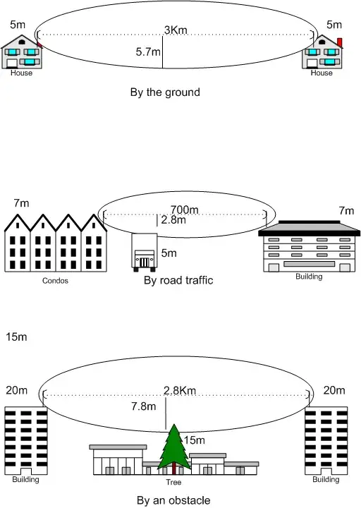

The link will be used to transmit the video feed of 1 (or even possibly two) IP cameras and some kind of Ethernet-enabled environmental or weather sensor. I have checked the necessary b/w for the cameras and both 900Mhz and 5.8Ghz are more than adequate for even 4 of them, much more for 2. I have also verified that there is clear line-of-sight to both possible installation points and that the 60% Fresnel Zone clearance is more than covered. Bear in mind that this is my first long distance link (long with or without quotes) and I hate to admit that wireless physics is far from my strong suit.
