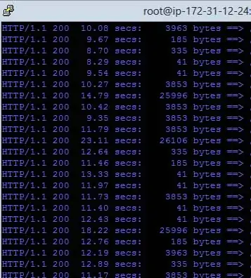

I am doing siege tests siege -d5 -c150 if I do only 1 siege I see responses times that are less than 1 sec. If I add another server to do another siege -d5 -c150 my response times go up the roof to 9-15 sec`

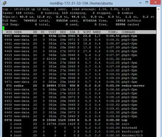

I am very new to servers setups but somethings tells me that if my server is always average of 40-50% CPU load and consuming under 1GB of ram. I shouldn't see 10++ sec latency having so much free resources?
What could be my bottle neck or even better how could I find it??

siege results
ransactions: 1265 hits
Availability: 99.68 %
Elapsed time: 1196.10 secs
Data transferred: 21.30 MB
Response time: 11.48 secs
Transaction rate: 1.06 trans/sec
Throughput: 0.02 MB/sec
Concurrency: 12.14
Successful transactions: 1265
Failed transactions: 4
Longest transaction: 26.88
Shortest transaction: 0.00
