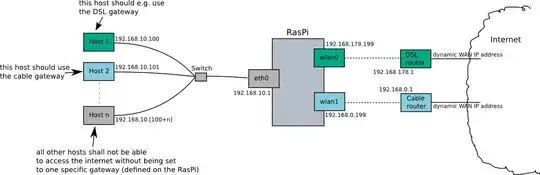

I have a Raspberry Pi (running Raspbian) with three network interfaces (one ethernet and two USB wifi nics). What I want to achieve is this: I have two WAN connections to the internet (DSL + Cable), and I want to set up the RasPi in such a way that it offers two default gateways. I want to make specific clients in my local network use the one or the other gateway. Here's an overview of what I want to achieve:
Usually, you can't have two default gateways for obvious reasons, but I found out that with iproute2 you can do exactly that and use multiple routing tables (and thereby default gateways) which are applied by rules. (See details of my configuration below)
The ethernet interface (192.168.10.1) is connected to a switch that connects my local network (192.168.10.0/24).
Interface wlan0 (192.168.178.199) is connected to the first WLAN router (DSL) (192.168.178.1). Interface wlan1 (192.168.0.199) is connected to the second router (Cable) (192.168.0.1).
Here's my /etc/network/interfaces

What do I have to do to make the clients (with a static ip, no DHCP needed) in my local 192.168.10.0/24 network use the RasPi as default gw (192.168.10.1 - the eth0 interface) to access the internet? I think that's done with masquerading and iptables, but I have no clue on how to do that with this setup.
How would I have to change the
iprules to not only let the clients connect to the internet just as the RasPi itself can, but instead use the one or the other gateway? For example, if I would like to make the host 192.168.10.100 use the "ALICE" gateway and 192.168.10.101 use "BOB"?
I feel quite close to the finishing line, any help on this probably not so common issue is greatly appreciated. Thanks in advance!
