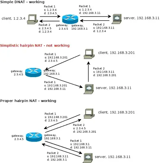

This question applies to services provided by servers on RFC1918-addressed IPv4 networks, which are made available to external users by introducing destination NAT (DNAT) at the gateway. Internal users then try to access those services via the external address. Their packet goes out from the client to the gateway device, which rewrites the destination address and immediately injects it back into the internal network. It is this sharp about-turn the packet makes at the gateway that gives rise to the name hairpin NAT, by analogy with the hairpin turn.
The problem arises when the gateway device rewrites the destination address, but not the source address. The server then receives a packet with an internal destination address (its own), and an internal source address (the client's); it knows it can reply directly to such an address, so it does so. Since that reply is direct, it doesn't go via the gateway, which therefore never gets a chance to balance the effect of inbound destination NAT on the initial packet by rewriting the source address of the return packet.
The client thus sends a packet to an external IP address, but gets a reply from an internal IP address. It has no idea that the two packets are part of the same conversation, so no conversation happens.
The solution is that for packets which require such destination NAT, and which reach the gateway from the internal network, to also perform source NAT (SNAT) on the inbound packet, usually by rewriting the source address to be that of the gateway. The server then thinks the client is the gateway itself, and replies directly to it. That in turn gives the gateway a chance to balance the effects of both DNAT and SNAT on the inbound packet by rewriting both source and destination addresses on the return packet.
The client thinks it's talking to an external server. The server thinks it's talking to the gateway device. All parties are happy. A diagram may be helpful at this point:
