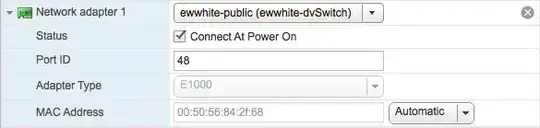

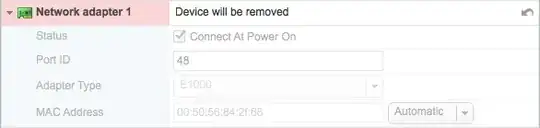

The answer is that you really shouldn't change the type of adapter in-flight. The more accepted process is to remove the existing adapter and add a new adapter of the type you desire.
existing E1000 NIC attached to a VM
remove the E1000 NIC

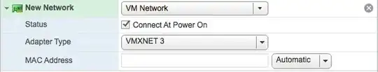

add a new Network device
specify the type of adapter to be used in the new network device
In your operating system, reconfigure network settings.
