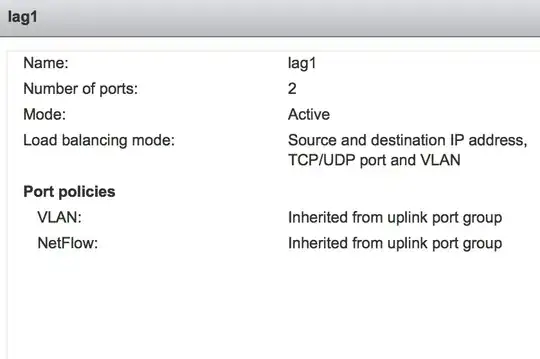

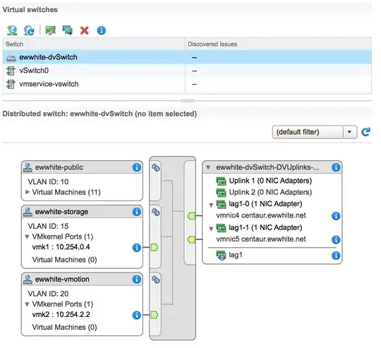

Summary: My problem is I cannot use the QNAP NFS Server as an NFS datastore from my ESX hosts despite the hosts being able to ping it. I'm utilising a vDS with LACP uplinks for all my network traffic (including NFS) and a subnet for each vmkernel adapter.
Setup: I'm evaluating vSphere and I've got two vSphere ESX 5.5 hosts (node1 and node2) and each one has 4x NICs. I've teamed them all up using LACP/802.3ad with my switch and then created a distributed switch between the two hosts with each host's LAG as the uplink. All my networking is going through the distributed switch, ideally, I want to take advantage of DRS and the redundancy. I have a domain controller VM ("Central") and vCenter VM ("vCenter") running on node1 (using node1's local datastore) with both hosts attached to the vCenter instance. Both hosts are in a vCenter datacenter and a cluster with HA and DRS currently disabled. I have a

Network Setup: Here is my distributed switch setup (JPG). Here are my networks.
