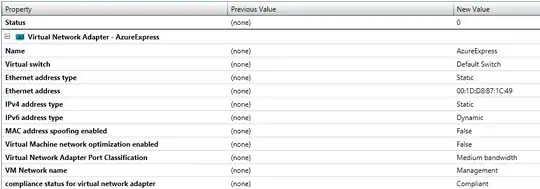

When I deploy a VM to the host with an vNIC attached to the virtual management network something very strange happens, or what I think is strange. Initially everything appears to work correctly, a vNIC is added to the VM:
and an IP address from the correct pool is allocated to the vNIC

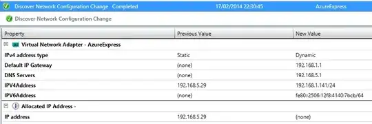

At this point all is well, everything is happening as I expect, however after the VM has warmed up, joined the domain, rebooted, etc. the following event appears:
where the vNIC's address type is set to be dynamic, the allocated IP address is deallocated and it gets an IP address from the routers subnet 192.168.1.0/24.
I am assuming that this is because the adapter reaches out and discovers that there is a DHCP server through the hosts adapter and requests an address from the router. Although I would have thought it being set to static would have prevented that.
