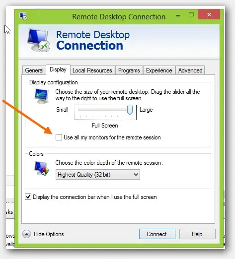

In my case, Critix Player shows me up with a remote desktop log in window exactly same as Windows' default remote desktop program.
(Disclaimer: I am not allowed to post the exact screen shot but the one below from internet is what I see )
As soon as the checkbox below gets checked, I do not have to do monkey with the dragging and resizing the window. Also, please make sure that the slider is set towards the right most corner such that the value below reads "full screen". If you do not see something similar to below, try to find an option which reads "show options" and clicking on it would expand your window, then click on "Display" tab.
