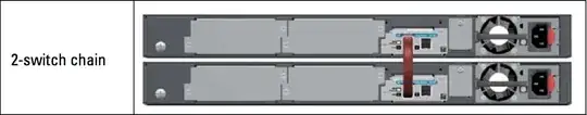

- For a two-switch setup, does it make sense to stack these switches via the stacking modules (additional $900 per-switch, plus stacking cables)?

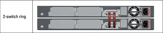

- If I do stack, should this be done with a single link between stack members or a dual-cable link topology (shown below)?
