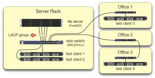

We put a 4 port Intel I340-T4 NIC in a FreeBSD 9.3 server1 and configured it for link aggregation in LACP mode in an attempt to decrease the time it takes to mirror 8 to 16 TiB of data from a master file server to 2-4 clones in parallel. We were expecting to get up to 4 Gbit/sec aggregate bandwidth, but no matter what we've tried, it never comes out faster than 1 Gbit/sec aggregate.2
We're using iperf3 to test this on a quiescent LAN.3 The first instance nearly hits a gigabit, as expected, but when we start a second one in parallel, the two clients drop in speed to roughly ½ Gbit/sec. Adding a third client drops all three clients' speeds to ~⅓ Gbit/sec, and so on.
We've taken care in setting up the iperf3 tests that traffic from all four test clients comes into the central switch on different ports:
We've verified that each test machine has an independent path back to the rack switch and that the file server, its NIC, and the switch all have the bandwidth to pull this off by breaking up the lagg0 group and assigning a separate IP address to each of the four interfaces on this Intel network card. In that configuration, we did achieve ~4 Gbit/sec aggregate bandwidth.

Since the clients' aggregate bandwidth only comes together in a single place — at the switch in the server's rack — only that switch is configured for LACP.
