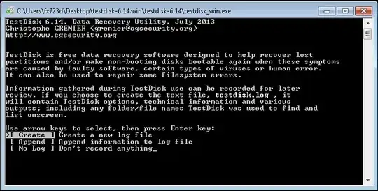

Select Create (using Enter key) to create a log file

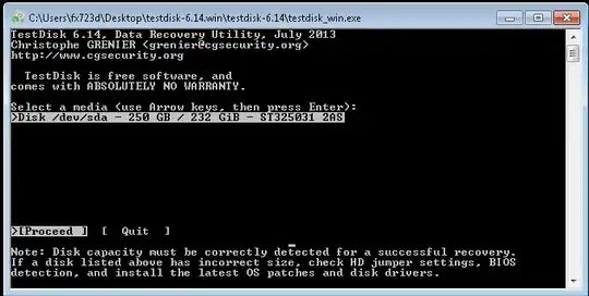

Highlight the broken disk using the up/down arrows and select Proceed

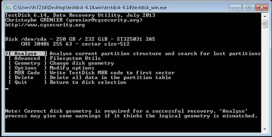

Select Analyse

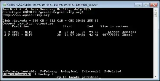

The "current" drive structure will be show, select Quick Search to find the correct drive structure.
This screen may take awhile to load. Here the detected drive structure will be shown. If you'd like you can select P to view the files on the selected partition. Select Continue from this screen.
If the partitions shown appear correct select Write to rebuild the partition table. If you think some partitions are still missing do a Deeper Search before writing the new partition table.
