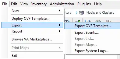

You can also export the VM from your ESXi host or vCenter by using the OVF Export option in the vSphere client.
You should be able to import the resulting VM file into your Workstation system.
