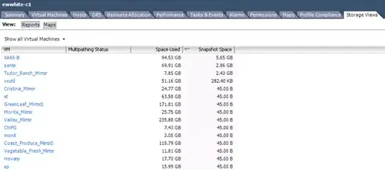

Grrr... VMware snapshots. If I had my way, they'd only exist for backup purposes and for testing changes.
You can view the space consumed by snapshots (which is probably what you're really interested in knowing) by using the "Storage Views" tab at the cluster level in your vSphere client.
Start there, then drill down to the individual VMs. The entries that have values in Bytes (B) essentially mean that there are no snapshots.
