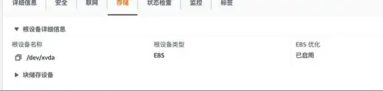

Then detach both two volumed(Stop the instance first, of course) ,and re-attach the new volume as the root device by filling in the device name here./dev/xvda as shown below

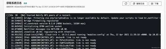

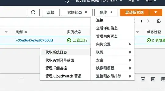

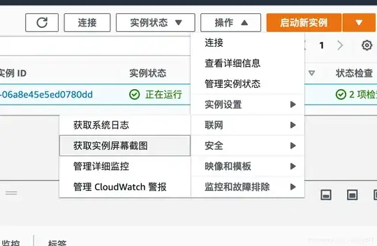

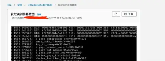

Then start the instance.If the ssh is failed, you can use the following methods to debug:
1. get system log
2.get screenshot
