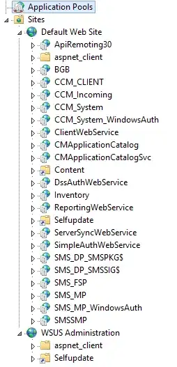

I verified that the WsusService was actually running and then checked IIS:
Huh. That's probably not good. The WsusPool Application Pool should probably be running... If I manually start the WsusPool I can then connect with the WSUS WebServices by browsing to http://SCCM.ad.contoso.gov:8530/Selfupdate... and then after about 15 minutes the App Pool stops.
Also its running on the wrong ports (8530/8531)! About a month ago with the assistance of PFE we configured this SUP to be available to Internet-based clients. Part of that reconfiguration meant the WSUS web services need to be relocated to 80/443 so they are available through our perimeter firewall.
I don't have documentation on the exact commands we used but I am reasonably sure it was WSUSUtil.exe usecustomwebsite false which should move WSUS from its "WSUS Administration" IIS back to the Default Web Site which is bound under *:80 and *:443.
Again. This is not the case:
Well that's not good. It looks like the WSUS site has magically migrated back to its standalone site because... FUN! If the SCCM SUP is looking for WSUS on 80/443 and it's no longer there no wonder it doesn't work.
If I look at the registry key (HKEY_LOCAL_MACHINE\SOFTWARE\Microsoft\Update Services\Server\Setup\PortNumbner) that WSUSUtil.exe is manipulating I see that it still thinks WSUS should be running on 80.
Maybe I just need to run WsusUtil.exe more than once for extra... FUN?
C:\Program Files\Update Services\Tools>WsusUtil.exe usecustomwebsite false
Using port number: 80
Except... nothing in IIS changes. I'm either not remembering a step we did previously to move the WSUS IIS Site or something is broken.
I really have two problems:
- The WSUS website 'WSUS Administration' has returned to its as-installed configuration as a standalone IIS website bound to *:8530 and *:8531 but underlying pieces of the system think it should be running under the 'Default Web Site' bound to *:80 and *:443.
- The WsusPool Application Pool keeps crashing or stopping preventing me from just reconfiguring the SUP point to use WSUS on its original *:8530 and *:8531 ports.
