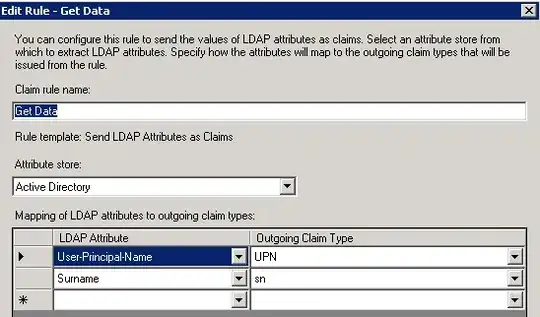

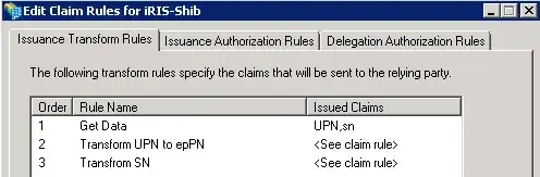

I currently have 3 claims rules:
Rule 1:

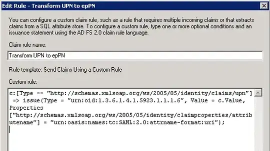

Rule 2:

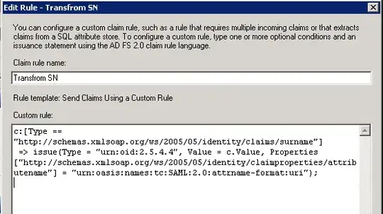

Rule 3:
From the logs on the Shibboleth SP machine, it doesn't appear that the sn is being sent as an OID attribute.
If I edit the attribute-map.xml and remove the references to the eppn, then I get the following in the shibd log:
2015-06-23 11:29:08 INFO Shibboleth.AttributeExtractor.XML [1]: skipping unmapped SAML 2.0 Attribute with Name: urn:oid:1.3.6.1.4.1.5923.1.1.1.6
There is no mention similar to the above output about the surname or sn in the shibd log, which makes me believe that the "Transform SN' rule is not written correctly.
UPDATED INFO:
I was able to get surname to work by changing rule 1 from manually typing in sn to selecting the dropdown option surname.

I'm adding fields such streetAddress.
For Rule 1, I've manually typed in streetaddress for the LDAP attribute and the outgoing claim type.
Then I added an additional rule:
c:[Type == "http://schemas.xmlsoap.org/ws/2005/05/identity/claims/streetaddress"]
=> issue(Type = "urn:oid:2.5.4.232", Value = c.Value, Properties["http://schemas.xmlsoap.org/ws/2005/05/identity/claimproperties/attributename"] = "urn:oasis:names:tc:SAML:2.0:attrname-format:uri");
I don't know if http://schemas.xmlsoap.org/ws/2005/05/identity/claims/streetaddress is correct or not, but the value isn't mapping.

I figured it out:
I changed the transform rule to the following:
c:[Type == "streetaddress"]
Instead of looking for Type == A schema, I just put street address. Then in Shibboleth SP, I changed the Attribute-map.xml to add this:
<Attribute name="urn:oid:2.5.4.232" id="streetaddress"/>
OID above was arbitrary.
