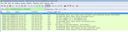

I'm investigating an odd issue with some embedded devices - long story short is that some of these devices (Possibly running a specific firmware version) aren't available through the NetScaler SSL VPN connection.
That's by the by, really, but during troubleshooting I noticed something that I'd like to know more about.
For testing, I set up a quick IIS server so that I could run WireShark and I get a subtly different traffic flow depending on whether I go through the VPN or not (Same machine, using Putty in RAW mode).
So, from WireShark on my IIS server (.117 below):
Without the VPN, from the Client I get the following traffic:
SYN
ACK
[Nothing happens, until I type "GET / HTTP/1.1" into Putty]
HTTP GET
ACK
FIN, ACK
With the VPN, from the Client I get:
SYN
FIN, ACK
HTTP GET
ACK
FIN, ACK
From my testing, I believe it's got to be the NetScaler that's sending that spurious FIN (I've tested from a machine in the DMZ, via the same Firewall etc and it doesn't have it) and I don't think it's out of the realms of possibility that an embedded device may not like it.
So, can anyone explain why NetScaler is doing this and how I can change it? I presume it's a TCP Profile configuration but I can't seem to figure it out.
I've attached two screenshots of the capture - both captures are using the same Client <-> Server and the same method (Putty). The only difference is whether I connect through the SSL VPN or not.
