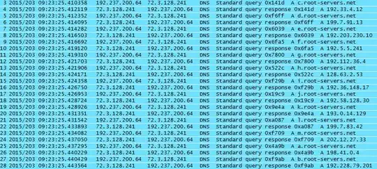

Note that in Packet#2, there are no Additional Records included. Which prompts my client to look up the A record for each of the provided Root name servers. Which happens in packets 3 thru 28:

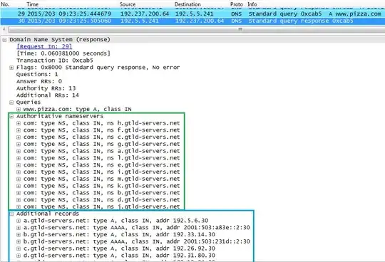

Packet 29 is my client, making a request to 192.5.5.241 (f.root-servers.net), looking for the A record for www.pizza.com. Obviously, the Root NS doesn't know the A record, so instead provides the .com TLD Name Servers' FQDNs (a.gtld-servers.net, b.gtld-servers.net, etc). Notice, the F Root NS also provides the "Additional Records", which are the A records corresponding to each of the .com TLD Name Server FQDNs:

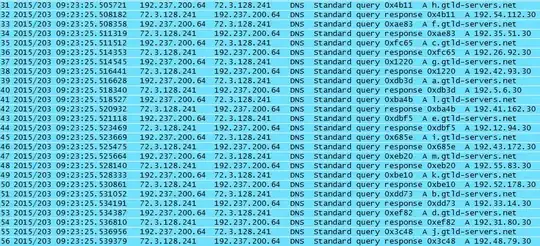

What follows next is what my question revolves around. Even though my client received the A records correlating to the .com TLD name servers. It still decided to make an A record requests for each of the .com TLD name servers (packets 31-56):
The same thing happens just a bit further down (packets 57-66) when my client asks the .com TLD name servers for the A record for www.pizza.com, and receives the Authoritative NS records for the Pizza.com domain. The .com TLD Name servers provide the glue records, but my client still goes out and manually resolves each NS server's A record manually.
