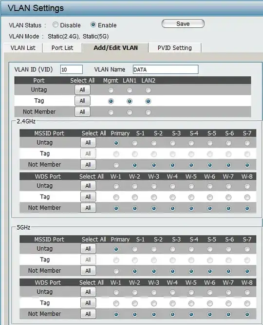

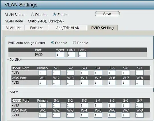

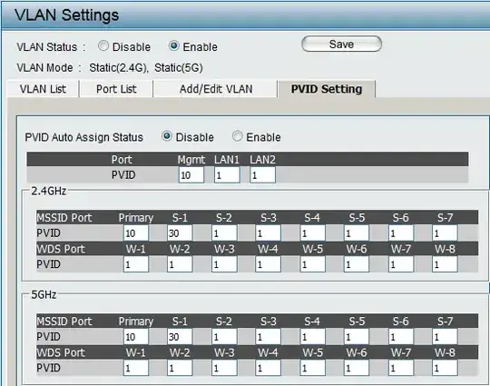

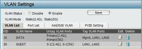

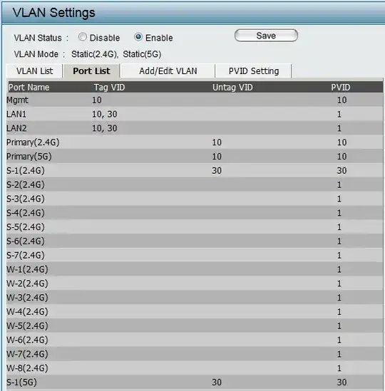

However, due to the APs being a newer version, the configuration has changed a little bit. Since the 802.11ac standard is good well past gigabit speeds over WiFi, these APs are equipped with two LAN ports. Also, they are designed to run over 2.4GHz and 5GHz simultaneously. This has made the configuration a little more complex. The strange thing is, I am about 95% sure I have properly duplicated my solution from the link referenced above, but I cannot seems to get these APs to work properly. PLEASE HELP ME!
Here are all the necessary screen shots of the configuration I am attempting. These are screenshots of the WAP configuration GUI first, and then my Cisco Catalyst second.
Wireless Access Point

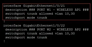

Cisco Catalyst 2960S
