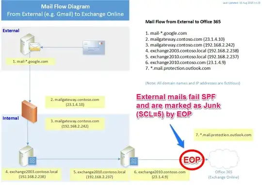

In short: legitimate emails are landing in Junk folders as EOP (Exchange Online Protection) stamps email messages as junk (SCL5) and SPF-failed. This happens with all external domains (e.g. gmail.com/hp.com/microsoft.com) to client’s domain (contoso.com).
Background info:
We are at the beginning of migrating mailboxes to Office 365 (Exchange Online). This is a Hybrid Deployment/Rich-Coexistence configuration, where:
- On-Premises = Exchange 2003 (Legacy) & 2010 (Installed for Hybrid Deployment)
- Off-Premises = Office 365 (Exchange Online)
- EOP is configured for SPF checking.
- MX records are pointing at the on-premises as we haven't completed migrating all mailboxes from on-premises to Exchange Online.
The problem is when external users sends emails to an Office 365 mailbox in the organization (mail flow: External -> Mail Gateway -> on-premises mail servers -> EOP -> Office 365), EOP performs an SPF lookup and hard/soft failing messages with the external facing IP address of the Mail Gateway from which it received the mail.
(On-premises mailboxes do not show this problem; only mailboxes migrated to Office 365 do.)

For message headers with X-Forefront-Antispam-Report, refer to http://pastebin.com/sgjQETzM
Note: 23.1.4.9 is the public IP address of the on-premises hybrid Exchange 2010 server connector to Exchange Online.
How do we stop external emails from being marked as junk by EOP during coexistence stage of a Hybrid Deployment?
