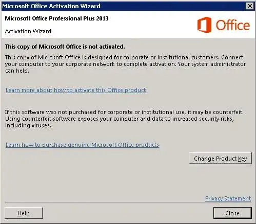

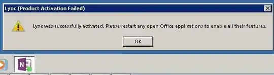

- But it has one flaw if part of Office 2013 was previously installed: Lync starts up and says it failed to activate. Then mere seconds after you click Close, it succeeds.
after that, it's fine for future launches of Lync. Also the Lync icon in the task bar looks like the OneNote icon for that first launch.

Based on all that, I decided to take a more drastic approach, but one that would even the playing field - I'm now removing Office 2010 and removing Office 2013 before installing Office 2013 again. I figured that would get me back to a 'clean install'. However, the Lync activation problem still persists!
I added a reboot, but same thing. As soon as Lync launches at login, the activation problem occurs, even after the reboot.
I've also tried removing Lync from startup before rebooting so it doesn't start automatically at next login. After the reboot, I waited a while and launched Excel. SAME activation issue! Interesting. This is not a Lync only problem.
