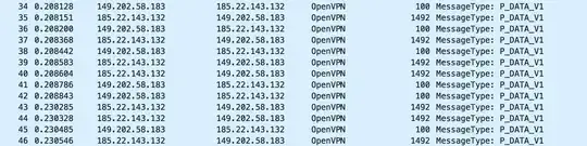

This is how the OpenVPN traffic of the test looks like:
To me this looks okay. But I do not know what to look for. Please have a look at the dump with wireshark: dump_physical.cap.xz

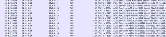

The traffic on the tunnel interface looks good to me, too. It seems that he correctly lowered the frame size (to 1444 as it seems):
Here is the dump: dump_tunnel.cap.xz
To me this looks all fine but I really have no idea what to look for exactly. I really tested everything out with the OpenVPN settings. Maybe someone can tell me if the traffic looks okay.
