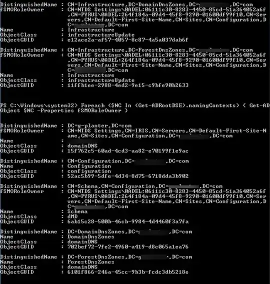

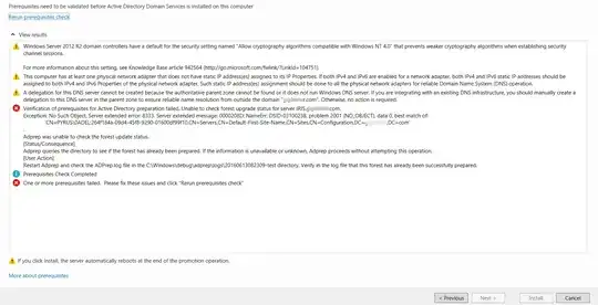

I came out with the idea to make one of the branch DC as main DC and add a new DC, LOTUS, on cloud and take over the main DC role later. I followed the steps here to seize the FSMO roles on IRIS and let LOTUS replicate everything from IRIS later. I followed the steps exactly, I seized infrastructure master, PDC, RIC master and naming master. I also deleted all DNS records on IRIS' DNS. When I tried to promote LOTUS as a new DC in the domain, I got these errors:
I spent half day looking for solution or possible clue on the error logs/event viewer of AD DC but couldn't find anything helpful to solve my problem.
I have limited knowledge on this screwed up everything. I have no clue on what to do now. Can anyone tell me the best solution for this or way to fix one of the issue above ?
