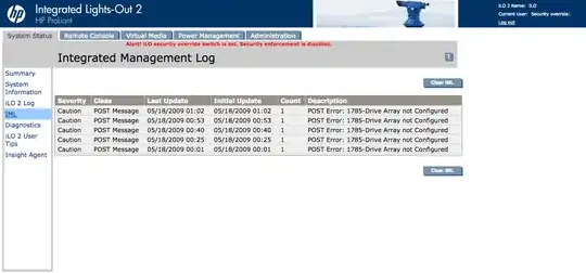

Try #1: - I thought it was an OS issue so I decided to reinstall my Linux then I found out there is 1 (of 3) drive in my RAID5 failed. - When I plug my monitor into the server, it was just a blinking white screen while booting and non-blinking white screen after that. - The IML log in iLO2 just keep displaying 1 drive failed & rebuilding the RAID5 array.

Try #3: - I removed all RAM, the health check start showing error (in server health board & IML log) immediately.

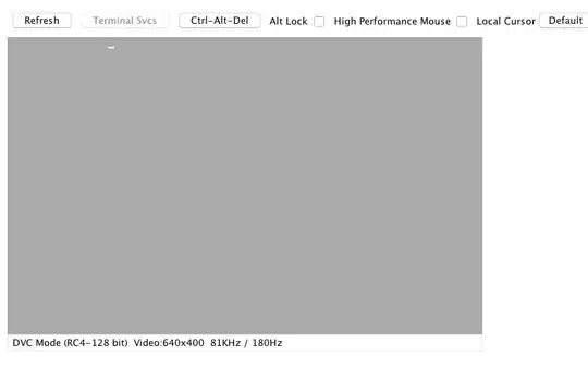

I install ILO Advanced license & see the same thing from the remote console:
- While booting the screen keep blinking (same as external monitor as seen in the YouTube-uploaded video)
- After booted, the whole screen is completely white (same as external monitor)

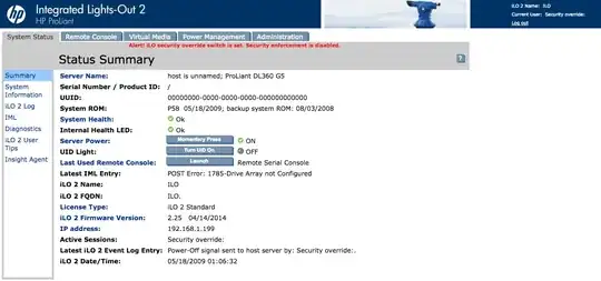

- I tried to turn On & Off the ILO Security switch but no changes to server (of course I will have to login to ILO if it's On)
Remote Console from iLO2 - The screen and the cursor keep blinking

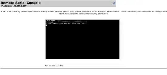

Remote Serial Console from iLO2 - The screen is not interactive (not responding)
