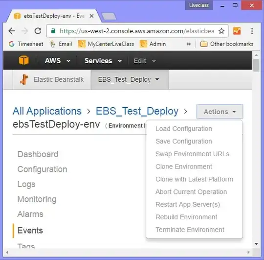

Is there any way to stop an elastic beanstalk environment as opposed to terminating it? There are times during testing that I would prefer to stop the environment so that I'm not being charged. However, I'm not seeing a way to do this via the GUI. It is very inconvenient to have to terminate and re-create my environment.
