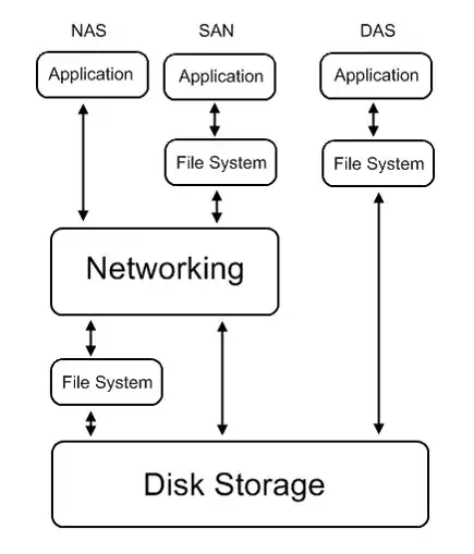

Block devices and filesystems
Most storage devices share the same physical and logical structure, in order to be able to locate the data you want, you need a way to identify where your data resides, so this is the reason of why Hard Disk drives have sectors (or simply "blocks"). In many cases this reflects the layout of the data written into the physical medium. Accessing your data by addressing the sector number, while not very complex, is error-prone, and you have to keep track yourself of the data you write and the sectors you have written to. This is where a filesystem comes to the rescue, a simple filesystem will help you by addressing the blocks used and providing you a common interface to retrieve your data, the most common paradigm used is the folder/file structure (this is why is it called a filesystem).
So essentially a filesystem simplifies the interface with your data, and takes care of the housekeeping and remembering in which blocks/sectors it puts your stuff. Normally in a file system you will not refer to block numbers to get your data, but to filenames. This explains the difference between a block device and a filesystem, a filesystem must reside on a block device.
DAS
The simplest storage is a Hard Disk connected to your computer/server. Hard disk drives need to communicate somehow, and they need to use a well defined physical interface and protocol in order for your computer to understand them, the most common interface and protocol employed today for PC is the SATA or Serial ATA (Serial Advanced Technology Attachment). So a hard disk which is physically connected through the same interface to your PC is identified as Direct Attached Storage or DAS for short. To make it clear, ANY block device which is directly connected to your system makes a DAS, even a USB stick (obviously the physical interface is USB). And unless you access your disk by block numbers, you need a file system on top of it in order to put it to good use.
NAS
But what if you want to provide access to your filesystem to other computers (for sharing or transferring files)? Many protocols have been created over the years to accomplish file sharing on a Network with other computers. I will only name the main ones, per Operating System: UNIX and similar - NFS; DOS/Windows - CIFS (a.k.a. SMB); Apple - AFP. What they do is share files over a network. Of course "file" implies an underlying filesystem structure and filesystem implies block device, but because it's done over a network it's called NAS - Network Attached Storage. All of these interfaces explicitly prohibit remote lookups of block addresses (for security reasons first) and normally such lookups are not even implemented. Network file systems can be considered safe enough to be used in a concurrent way (YMMV), the Protocol implementation will take care of problems due to concurrent access to the same resource (file), normally by locking the file to a single user/requester. While any computer can share files over a network and be called NAS, solely by the power of marketing, NAS has come to mean devices whose main purpose is to share files over the network. So, if you build your own server whose only purpose is to serve files over a network, is it a NAS? Of course it is. Typically (but not exclusively) a NAS device operates on TCP/IP networks and most can easily provide access to your data over the Internet.
SAN
Let's say that I like to read my data by block numbers, because I've written my own software but I'm in need of many disk drives, more than a single computer can host. The solution would be to share the disks of other computers, but as said before my NAS doesn't provide a way to look up block numbers remotely. So I will need to use another protocol to share my disk drives, one that doesn't need a file system to operate. The following interfaces/protocols/networks exists today to share disks over a network:
- SCSI - Small Computer System Interface. SCSI is a venerable low level protocol regularly used/encapsulated into secondary or transport protocols to send commands between controllers and disks. It is the under-pinning of many currently used protocols.
- SAS - Serial Attached SCSI. This allows creation of entire SANs, as SAS supports routing and addressing.
- FC - Fiber Channel
- iSCSI - Internet Small Computer System Interface. Usually uses Ethernet connectors and cables as its physical transport, but can run over any physical transport capable of transporting IP.
- ATAoE and similar - ATA over Ethernet
Virtually any low level protocol can be encapsulated into network packets and sent remotely to allow to access the hard disk as it was connected locally. Then you can read your data by block numbers or simply create a filesystem on the new block device.
