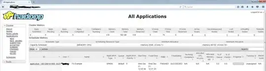

and I can open my Kererized Hadoop UI.

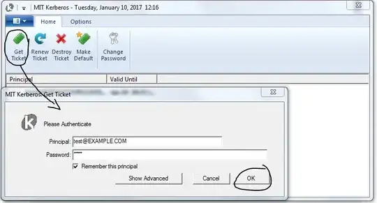

Problem makes my Windows client. I set it up by copying the krb5.conf file from the KDC machine to the Windows client and renamed it to kdc5.ini.
I also set the computer's domain:
C:> Ksetup /setdomain EXAMPLE.COM
After a restart I tried to connect to my KDC Realm via
C:> kinit testuser@EXAMPLE.COM
Password for testuser@EXAMPLE.COM:
<empty row>

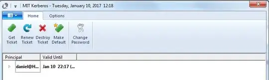

Everything looked fine so far, but when I call klist I get only the following result:
Aktuelle Anmelde-ID ist 0:0x7eca34
Zwischengespeicherte Tickets: (0)
In English something like ... cached tickets: (0)
I'm also unable to open my website on the Windows client, so I guess that there's an interoperability issue as I didn't have any problems connection via my Ubuntu client.
