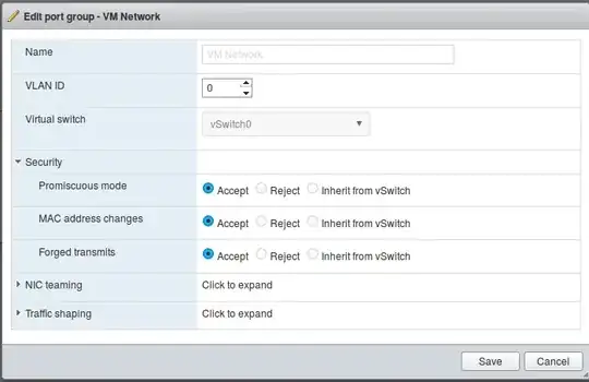

Edit: I figured out what the problem was and wanted to post it here so it could help if anyone else had the same problem.
In ESXi, promiscuous mode needs to be configured at the vSwitch. This allows nested VMs and containers to use bridging. Please see this article for further information: https://egustafson.github.io/esxi-nested-virtualbox.html
