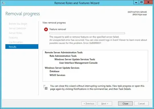

In server manager, if I try to remove the Database role, I get this message:
The Request to Add or Remove features on the specified server failed. an unexpected event has occurred. You can view event logs in Event Viewer to learn more about possible causes for this problem. Error: 0x800f0831
