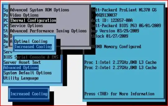

Bottom line, your RAID controller should not be at that temperature. Increasing fan speed would only mask or be a shim for a deeper problem.
It's possible to increase fan speed in the BIOS, but depending on your answers to the above, you may be looking at a different problem.

Thanks so much for such a comprehensive answer! I completely forgot about the Thermal Configuration in BIOS. If I set it to Increased Cooling, the fans go to around 40% and the temperatures drop 20 degrees. – Brane Apr 29 '17 at 17:41
