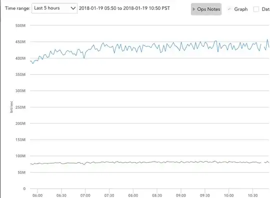

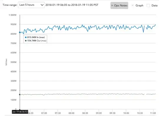

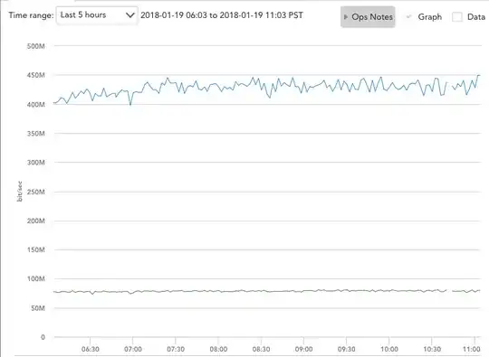

It seems like the traffic is being perfectly load balanced - but the bandwidth graphs still show almost exactly 500mbps per interface, when rx and tx are combined:
I can also say for a certainty that, when it is serving production traffic, it is constantly pushing for more bandwidth and is communicating with multiple other servers at the same time.
