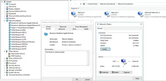

Here you can see the details on the host.

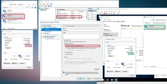

The above picture is on the hyper V host. I have added Network 2 to the hyper v switch manager as Network 2.
Here you can see a picture of the Virtual switch manager and the network connection in the guest.

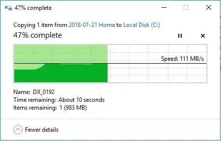

It's not the disk, because on the guest I can shuffle files around between the harddrives at around 100MB/s. Picture below is the guest copying files from one drive to another.

Red is the host operationg system. Green is inside the Hyper V machine.
