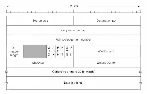

When data is sent over the network, it needs to be encapsulated into so called "frames." There are various methods of encapsulation depending on the protocol and topology that are being used. The following images show how TCP and UDP frame structures differ.
This is the TCP frame structure:

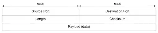

An this the UDP frame structure, much simpler:
