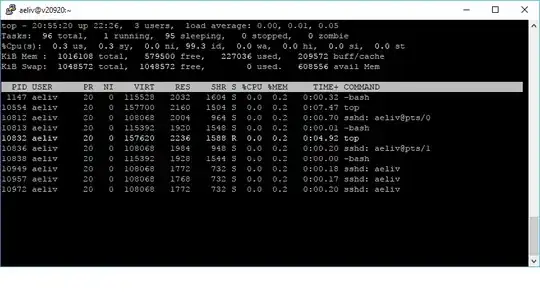

Also: I went with some unsuccessful tries to server. But from the top command (using Windows Server) I see connections which hang.
