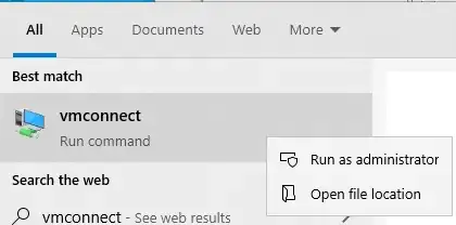

- Opened vmconnect.exe as admin manually
