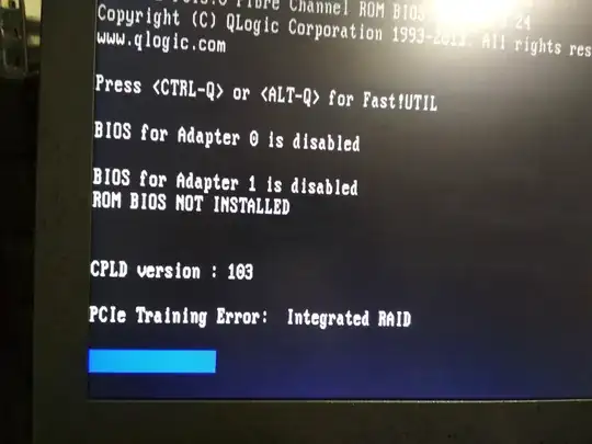

After the startup, the server show the "PCIe Training error :Integrated RAID"

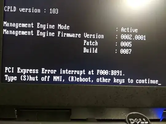

And then "PCIe express error interrupt at F000:B891"
My thought is that the controller raid is broken
Any help?
Any help?
This mainly occurs due to a faulty PCIe slot, just remove anything that is connected to the slot no, or change the entire card if possible
Remove power cables and press power button for 10 sec and wait for 5 to 10 min, then start the server, it will work most of the times. if not you need to reconnect PCI cards and try. if there is any H/W issue contact hardware vendor.
This is an old question, but I had the same issue on a Dell R520.
Reseating the cards did not help -> I replaced the Perc H710 Mini RAID Controller with a new one - error fixed.
