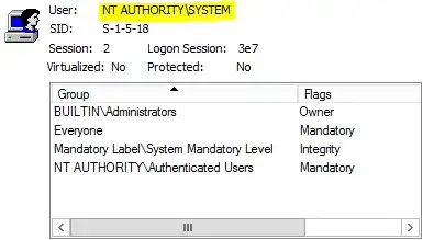

If the Service SID Type is "none" then the service just gets a plain SYSTEM token, the same as is used by other system processes such as services.exe and winlogon.exe and so on. This is the legacy situation; back in Windows XP all services had this sort of token, unless they were configured to run as a particular user account.

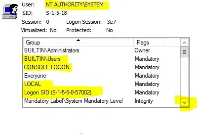

As you have already observed, as well getting the NT SERVICE identifier, the token is given a number of other identifiers. This isn't documented as far as I can see but also isn't especially surprising; it makes the service token more like an interactive token would be, which can be useful. (It is particularly important that this be the case for restricted tokens, which would otherwise have very little access at all.)
As described in the self-answer, when multiple services are shared by a single process the process token has to contain every SID that any of the services needs. So if the Group Policy Service (or any other service with a SID type of "none") is sharing a process with an "unrestricted" service, it gets the exact same token as if it were itself "unrestricted".
