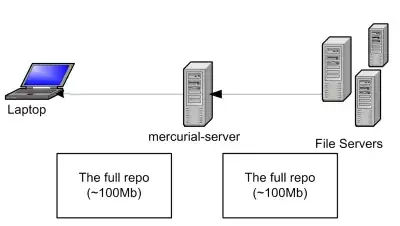

I need to know is there any solution for solving my problem. I have a BIND DNS server and consul as service discoverer. This is what i want as simple diagram:
How can I configure this sample setup and let BIND just resolve the A record to the IP address of the healthy load balancer server?
If the client queries the DNS server for the A record of domain.example, it must get the IP address of the Healthy (192.168.1.100) server
