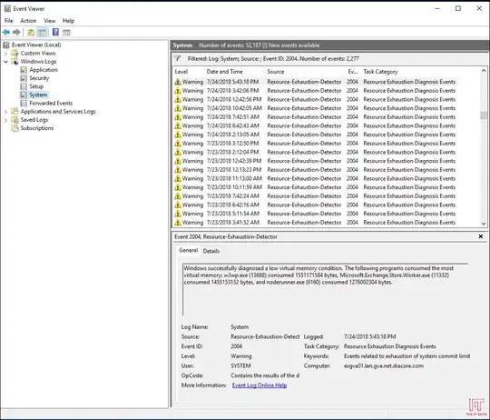

I'm running an Exchange 2016 CU6 on a Windows server 2016 VM and I am frequently getting warning in the application log saying that I am out of virtual memory (pagefile).
My monitoring shows that the pagefile has been at 4GB since the VM was created in April, it has never increased beyond 4GB nor has it decreased.

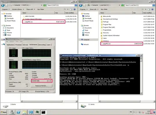

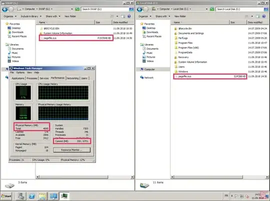

My test VM 2016 is currently using 512MB on the C: drive and 1GB on the G: drive, totalling 5.5 of committed memory
The test VM 2008 is currently using 512MB on the C: drive and 4GB on the G: drive, totalling 12.5GB of committed memory
After researching a lot about committed memory, I have found this article from Mark Russinovitch: https://blogs.technet.microsoft.com/markrussinovich/2008/11/17/pushing-the-limits-of-windows-virtual-memory/

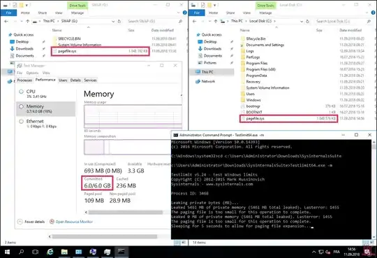

I've decided to use the tool testlimit64.exe with the -m switch to see if the pagefile would increase on the test VM 2016 and test VM 2008.
The result reflects the problem explained initially where the pagefile on the test VM 2016 does not increase on the G: drive, but it does on the test VM 2008:

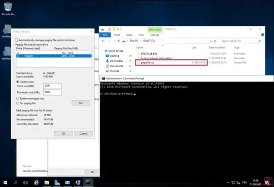

My last test was to configure the pagefile on the G: drive manually to 4096 - 8100 MB and run the tool testlimit64.exe with the -m switch again, and as you can see the pagefile does increase from 4GB to ~8GB
