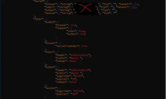

To prevent unauthorised access to my server, I used to have a JWT authentication key inside my /etc/onlyoffice/documentserver/default.json file for browser, inbox, outbox and session strings. After updating to version 5.2.0, I had to reset my default.json file to default (from the GitHub repository) as ONLYOFFICE would not work otherwise for some reason (?), and then I set my PostgreSQL DB password correctly as well as the four key strings (all equal) mentioned above.
I also ensured that secret key authentication was set on true for all three options (browser, inbox and outbox).

Here's a screenshot of the relevant part (starting at line 132) of my /etc/onlyoffice/documentserver/default.json file (where the red X is, I covered my secret key in Snipping Tool for privacy).
