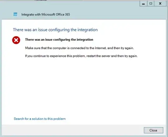

Everything on the new server appears to be functioning correctly. However I don’t believe the new Exchange2016 server has all the proper send/receive connectors to get into Office365. On the old exchange server, it contains specific IP addresses within the send/receive connectors to communicate with Office365.
I was trying to run the Hybrid Configuration Wizard within the new Exchange2016 server in case there was anything the setup missed.
However, please look at the screenshot.
- Should I choose both options?
- Or should I only choose the new server?
- The old server is still in production and will remain for a few weeks, and it’s already configured for Office365…. So I am not sure if I should be choosing it again?
I don’t know, if I don’t choose the old server….. will it remove the old server from the hybrid configuration? How do I move forward?
EXCH2010 is the current server already configured with Office365.
Hybrid is the new server, it’s pretty much configured but just missing some of the inbound/outbound office365 connection settings.
All I am trying to do is make sure the new server is configured correctly for hybrid, while leaving the old server intact.
