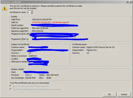

But then up pops a warning saying that the certificate expired on 2019-01-04.
If I click Ok, it continues, but then it says: Primary connection and data connection certificates don't match. Here's the log following the "Initializing TLS..."

It's like the Initializing TLS logic is somehow grabbing the OLD certificate, but once it connects, it's grabbing the NEW certificate and seeing they don't match.
If I update the IIS FTP server to use the OLD certificate and retry connecting, I get the same expired certificate warning on Initializing TLS, but then when I click Ok it connects and I can transfer files without issue (albeit, I have to confirm that the certificate is expired every transfer).
