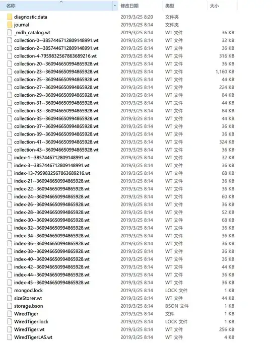

Here are our files in the directory, and the files was generated under MongoDB version 3.4.

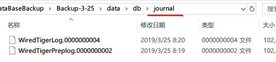

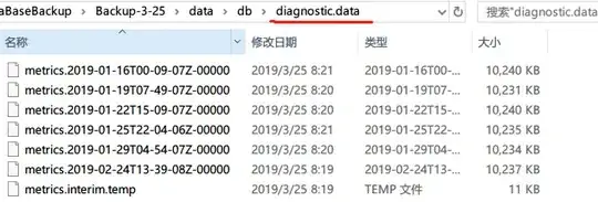

Folder diagnostic.data:
Folder journal:

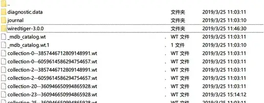

I created a folder db_backup and put all my files into it. And I created a folder wiredtiger-3.0.0 under db_backup.I installed wiredtiger in folder wiredtiger-3.0.0:

I have checked my directory argument and I found no fault. In the picture, the file collection-23--360946650994865928.wt is right Here.
The snapshot of collection-23--360946650994865928.wt just has been salvaged.

2) collection-23--360946650994865928.wt contains our most important data. If we could not restore the whole database, extracting data from that file will be still very useful. However, if we do copy paste manually, not all the characters are well written; they still need to be decrypted. Does anyone know how to do that?
3) is it possible that we did not recover all the files (or the entire body of all the files) under /data/db?
