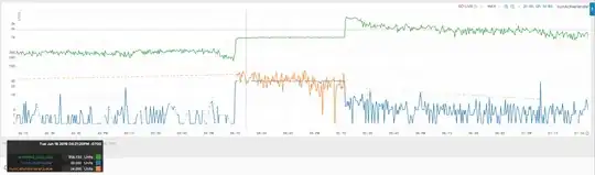

During the same period, another metric hbase.regionserver.ipc.numCallsInGeneralQueue behaves abnormally too.
Attaching a plot showing them together.

The culprit is scanNext requests going to that region server. However the situation is more complicated.
The following chart includes the scanNext operation count on the same region server. Please note now the y-axis is in log scale.
At the start of the anomaly (4:15PM) there was a rise in the scanNext requests. From what I know about the service that sent the requests, the scanNext request count must have been larger between 4:15PM to 5:20 PM compared to later than 5:20PM. I do not know the exact scanNext request number between 4:15PM and 5:20PM, my unproven back of the envelope calculation suggests that it should be about 5% more.
Because of that, I think this scanNext num ops metric is misleading. It may be the completed scanNext operation count. Between 4:15PM to 5:20PM, I think the regionserver was blocked on something else and could not complete the scanNext operations.
And, whatever that blockage was, I thought we could understand from the anomaly in the numActiveHandler and numCallsInGeneralQueue metrics. But I am having difficulty finding a good architectural document that gives insights about those metrics and what may cause that anomaly.
