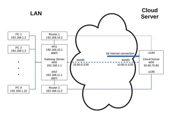

This solution applies Linux Ethernet Bonding to two independent OpenVPN connections from a local gateway server to a server in the cloud that you have root access to, like a Linode or a DigitalOcean Droplet. The two Internet connections that the OpenVPN connections are based on use two ADSL routers in transparent bridge mode, i.e. we use their modem functionality only and create connections via PPP over Ethernet (PPPoE) driver. And the firewalls are implemented with FireHOL on both ends of the bonded connection.
The graph gives an overview. The LAN PCs are connected to eth0, 192.168.1.1/24, on the Gateway Server. The two routers are connected via individual, physical network interfaces eth1, 192.168.10.1/24, and eth2, 192.168.11.1/24. (Couldn't make PPPoE work with virtual interfaces on eth0.) The PPPoE driver creates interfaces ppp0 and ppp1 for individual connections to the ISP. OpenVPN binds to the Gateway Servers' 192.168.10.1/24 and 192.168.11.1/24 addresses on the LAN side, and to ports 1194 and 1195 of the Cloud Server's eth0 interface, 50.60.70.80/24. And these two OpenVPN connections are then bonded to create the virtual interfaces 10.80.0.2/30 on the LAN side and 10.80.0.1/30 on the Cloud Server side. Defining the Cloud Server's 10.80.0.1 address as default gateway on the LAN's Gateway Server allows all LAN computers to access the Internet at almost double the speed of one individual PPPoE connection.
The following configuration is based on Ubuntu Server (works here with 16.04 on the LAN side and 18.04 on the Cloud side). All commands assume root privileges.
