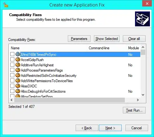

Now, strictly speaking, you didn't need to create a compatibility mode because you can apply specific fixes here. I had you do that in case you need to add additional fixes to that mode later so they'll apply to all apps that you put under that mode. So you can just hit Next without doing anything on the Compatibility Fixes step.
no extra fixes necessary
