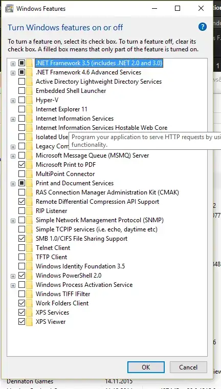

I was trying to install the Windows Media Pack for my Windows 10 Pro N Edition, which was necessary after updating to Version 1511.
The problem is now, that the MediaPack was successfully installed, but there are no new MediaFeatures listed in "Turn Windows features on or off", which means that i dont have access to the Media Player, nor cant i uninstall the Media Pack to try again. Windows does not allow me to reinstall the MediaPack as shown in the picture below.
Does anybody know how to solve this? Thx in advance.
Uninstalling
Uninstalling KB3010081 via cmd gives me the following error:

  • Before the Update the Media Pack was successfully installed and working. Windows does not allow me to uninstall the KB. Can i force Windows to do so or do i have to try the rollback? One more thing: The Kb ist not listed in the "Uninstall an update" Section – luQ Nov 18 '15 at 16:59
  • I did the roll back and its working in the older version. I guess now update for me then. – luQ Nov 18 '15 at 17:28
  • the Media Pack can't be uninstall officially. Do you want to apply a hack? – magicandre1981 Nov 18 '15 at 18:15
  • What kind of hack? :D – luQ Nov 18 '15 at 18:20
    editing a windows file. Run notepad.exe as admin, go to **C:\Windows\servicing\Packages**, find the Package_for_KB3010081 MUM (not the other MUMs with the KB number) and remove the entry **permanence="permanent"** but make sure you don't remove the **>**. now try to uninstall the update – magicandre1981 Nov 18 '15 at 18:35
  • @Marty post a list of all KB3010081 MUm files in the folder – magicandre1981 Dec 05 '15 at 08:16
There is a newer version of Media Feature PackKB3133719. It should fix the issues with your current installation.

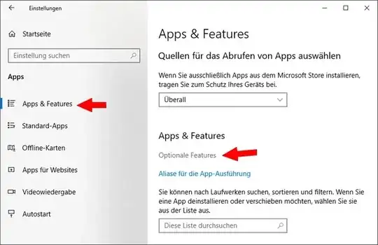

Installing via "Add or Remove programs" -> Optional Features solved the similar problem. enter image description here
https://borncity.com/win/2019/11/14/media-feature-pack-windows-10-n-1909/
