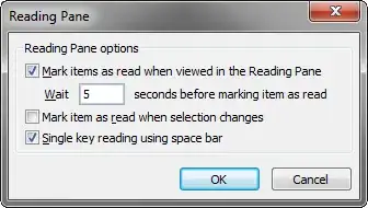

Can someone describe to me, step by step, what I would need to do in order to change the default Outlook "Mark as Read" behavior?
Default Behavior: Outlook marks a message as read when It has appeared in the viewing pane and I move to another message.
Desired Behavior: Outlook marks a message as read as soon as it appears in the viewing pane.

It took me a few minutes to figure it out in Outlook 2010 and Outlook 2016 - once you get to the Reading Pane options, it's the same as squillman's answer.
  1. Go to FileOptionsAdvanced.
  2. In the Outlook panes section, click Reading Pane...
    The Outlook Options dialog
  3. Check Mark items as read when viewed in the Reading Pane and set an interval in seconds before it kicks in.
    The Reading Pane dialog
Note: In Outlook 2016, the same dialog is also available in the ribbon under View → Reading Pane → Options....

    The wait interval can be set to zero seconds. – Keyslinger Jul 25 '14 at 20:35
    Setting to 0 seconds results in instantaneous marking as read, as opposed some other settings configurators where 0 means the setting is ignored. – Paul Nov 11 '14 at 18:08

For Outlook 2007:
  1. Go to Tools | Options and click the Other tab
  2. Click the Reading Pane... button under Outlook Panes
  3. Put a check the Mark items as read when viewed in the Reading Pane and set an interval in seconds before it kicks in.
It's the same for Outlook 2003, except that in step 2 the section on the Other tab is called "Reading Pane" instead of "Outlook Panes".

In Outlook 2016 (I assume it is the same for earlier versions), un-checking both "Mark item" options will leave the message as unread until you manually mark it as read or take some other kind of action. This is useful if you want to keep messages unread until you reply.
I wanted to be able to set up individual mail folders with different reading pane options and could never figure it out. In the end, it's really just as easy to set up a shortcut key in Quick Steps to mark something as "read" and configure your reading pane options as shown. This gives you more control IMO.

just unclick all of the boxes in the Reading Pane Options and it will only show up as read when you double click to open the email.
I was confused that the option reading Mark items as read when viewed in the Reading Pane wouldn't allow for it to simply Mark items as read when viewed in the Reading Pane without specifying a delay (setting 0 disables the option) — it turns out that selecting Mark item as read when selection changes has the desired affect.
