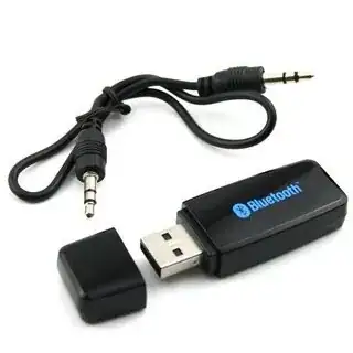

I have two speakers that I need to connect wirelessly via bluetooth. These are standard aux/usb speakers, and presently I've connected one of the speakers via 3.5mm jack to my windows 10 laptop. I have a bluetooth USB Dongle, that allows an aux output to my speakers to play music via bluetooth.
Bluetooth Dongle - Image
Can I connect my second speaker via a similar new dongle and place it in another room while playing music via both the speakers wirelessly/bluetooth?
