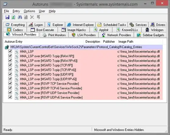

  1. Run Install.cmd as Administrator. To verify, that installation succeeded, you can use Autoruns:
Winsock Providers in AUtoruns
